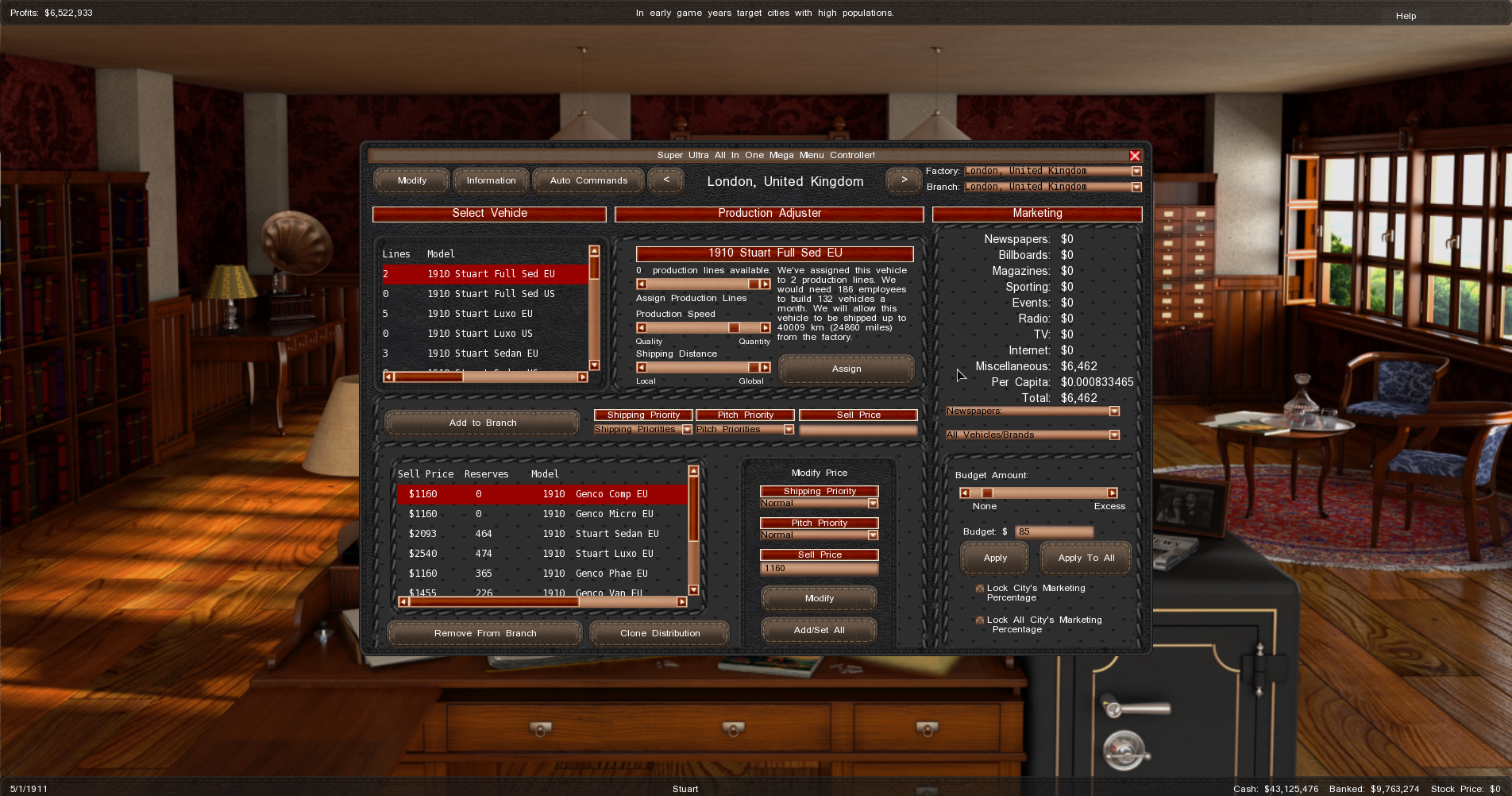

I just had something similar happen to me.
See screen shot, the game just zeroed out all marketing except for misc on all of my cities.
Save file also attached.
.rar   Stuart.rar (Size: 1.11 MB / Downloads: 473)
