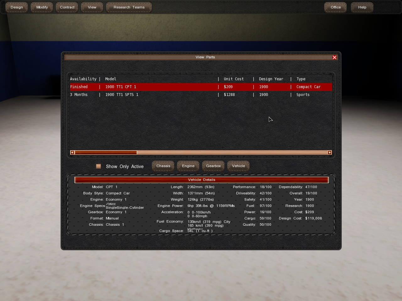

  • Vehicle : (Screenshot Attached)
    Rating is low but ive sold more on lower ratings before. I also designed the vehicle to be attractive in its two primary ratings.
    Body demand is also not a problem, as its a compact in asia in 1900 (high demand)
    Vehicle is also obviously not being penalized for being old in 1900-1903
