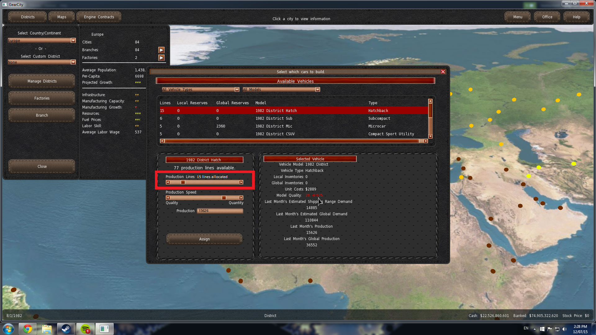

When using the district production menu, the value for last month's sales demand is 0 for all vehicles.

(07-11-2015, 05:39 AM)Shepherd Wrote: When using the district production menu, the value for last month's sales demand is 0 for all vehicles.
This basicly makes it unusable. Especially if you like me use the: just in time/no stock overhead strategy. Since I adjust production every month, I use this a lot. If you use the single factory screen the number is there.

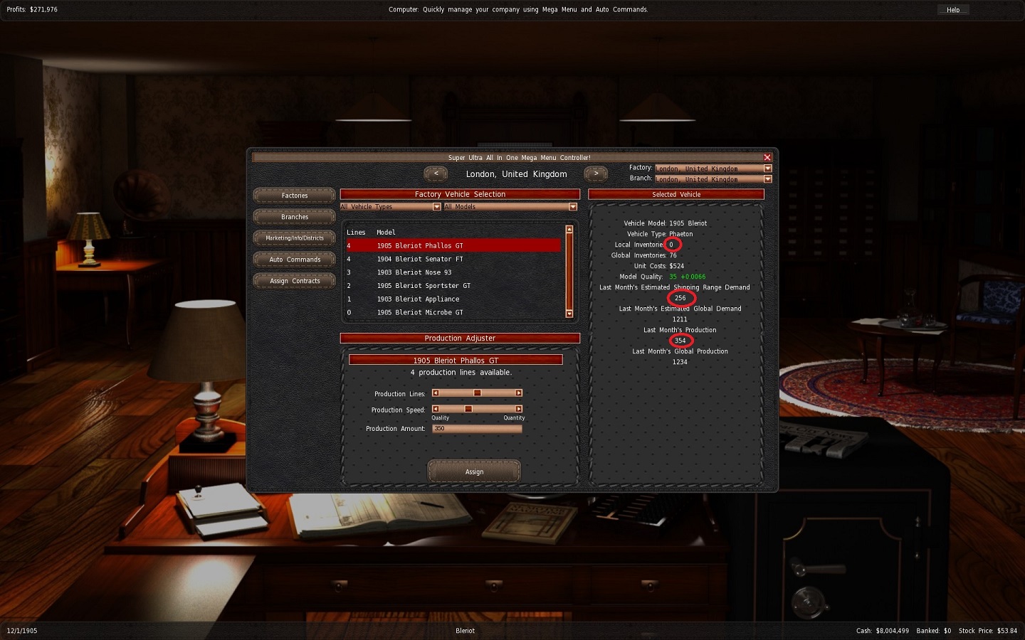

And another bug I have noticed after I expanded into Europe, is that in Europe it's screwed up. If you look at the above image I should be building stock, which I do not.
The reason for this seems to be that it only counts sales in London (240 units). I have tried with the default Europe shipping lock, and my own custom made. It makes no difference.
If you look at the District sale view the number sold sold + missed sales = 386 units. Which is what it should have shown.

Quote:And another bug I have noticed after I expanded into Europe, is that in Europe it's screwed up. If you look at the above image I should be building stock, which I do not.

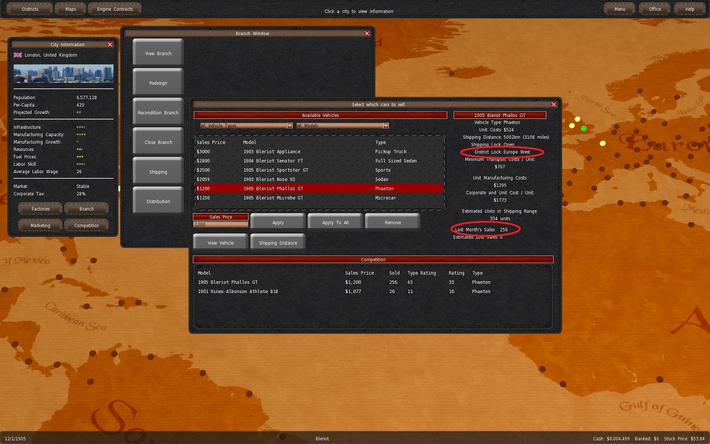

I don't think this is screwed up. Selecting the London branch shows the sales you made in London, 256 units. It also says that the shipping to London is locked to "Europe West". Which means you're only shipping from factories in "Europe West".
When you click on "Europe West" it shows you the sales of that vehicle in all the cities in "Europe West" combined. So 256 in London + Paris + Leeds + Whatever that other British city is. = 354 Units + 32 missed sales (probably in Paris, Leeds, or whatever.)
Quote:If you look at the District sale view the number sold sold + missed sales = 386 units. Which is what it should have shown.
Shown where? In London? Why? You didn't sell 386 units in London, you sold 256 units there and didn't have any missing sales.

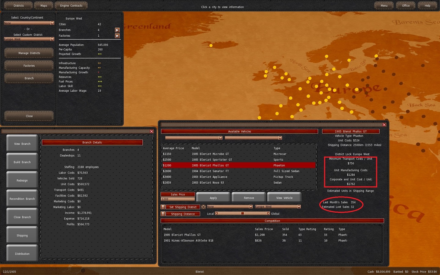

Quote:On a side note, the unit cost marked in the square seems way out of wack. But they have not seemed to be accurate before either.
It does seem transportation costs are out of wack since it's showing $700 to ship from London to London. Goes back to what I said earlier about moving shipping to branches. That being said, the costs have always been accurate, people just didn't understand how they're calculated. (All the money you spend in a month)/(all the cars you build and have in inventory) + unit costs + estimated transport = amount of money you need to charge to break even if you sold every vehicle built and in inventory.
I added the new manufacturing costs there to not include corporate expenses so people know what a single car's break even cost is. (Although this is not the breakeven for the company, you'll still lose money at price, which is the purpose of the other number...)

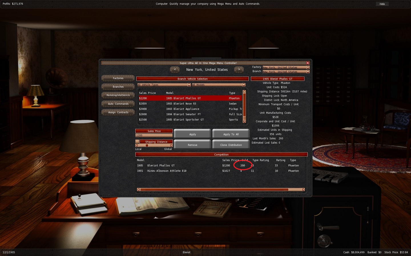

In New York factory you see it reports region sales almost correctly 759. The real sales figure in branch view was 804
Of which 260 was sold in New York.

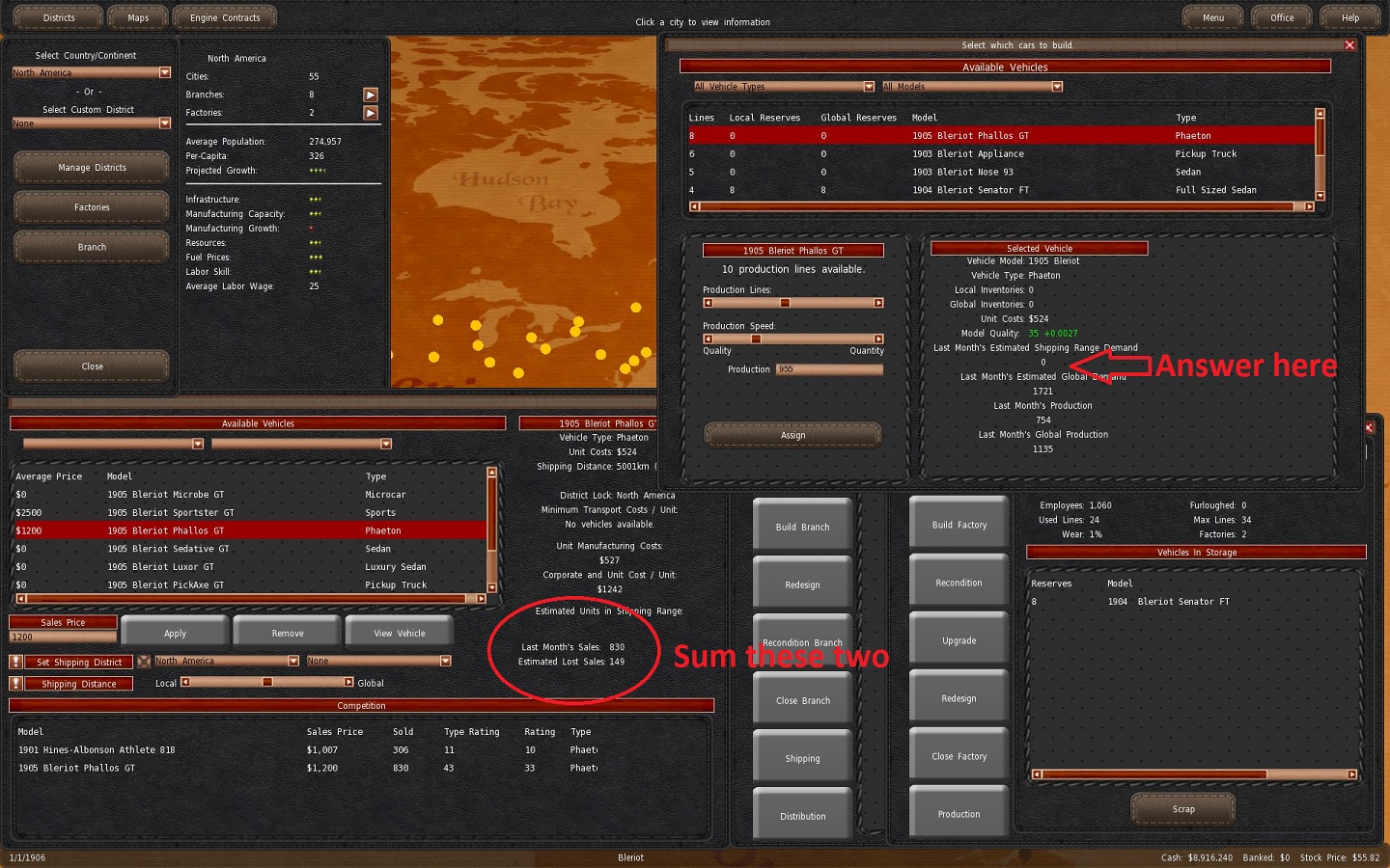

Could you not just sum the values from district sales and lost sales, and put it into the demand slot in district factory. As shown in picture under. That would be good enough I think.
(07-12-2015, 01:58 PM)Shepherd Wrote: Could you not just sum the values from district sales and lost sales, and put it into the demand slot in district factory. As shown in picture under. That would be good enough I think.
The problem with that is that factories can belong to multiple districts, and multiple districts and even places that are in no districts can still pull from a factory.
Just off the top of my head, your UK factory belongs to: Europe District, UK District, Europe West District, And City of London.
Paris Branch belongs to: Europe District, France District, Europe West District, and City of Paris.
So which summation I put there? If we use Europe, then you could have data from cities that are not being pulled from there. If we use UK, then you wouldn't have French sales data in the summation. If we use Europe West, what happens if you assign Canadian Branches to pull from UK? That data wouldn't be included because it's not in Europe West district. (The same issues if we use "Selected District" summation at the factory level. We have to parse shipping in every branch in the world for every factory in the selected district. I believe this is the only way to get the information properly.)
So no, that wouldn't work.

So for my Eu side of things. My defined district is Europe west, Currently built branches includes: London, Birmingham, Leeds and Paris. As you see of the picture under. They had 354 sales, 32 Lost sales.
Europe west production menu, should therefore show last months estimated sales of 386. At the moment there is only one factory and that is London.

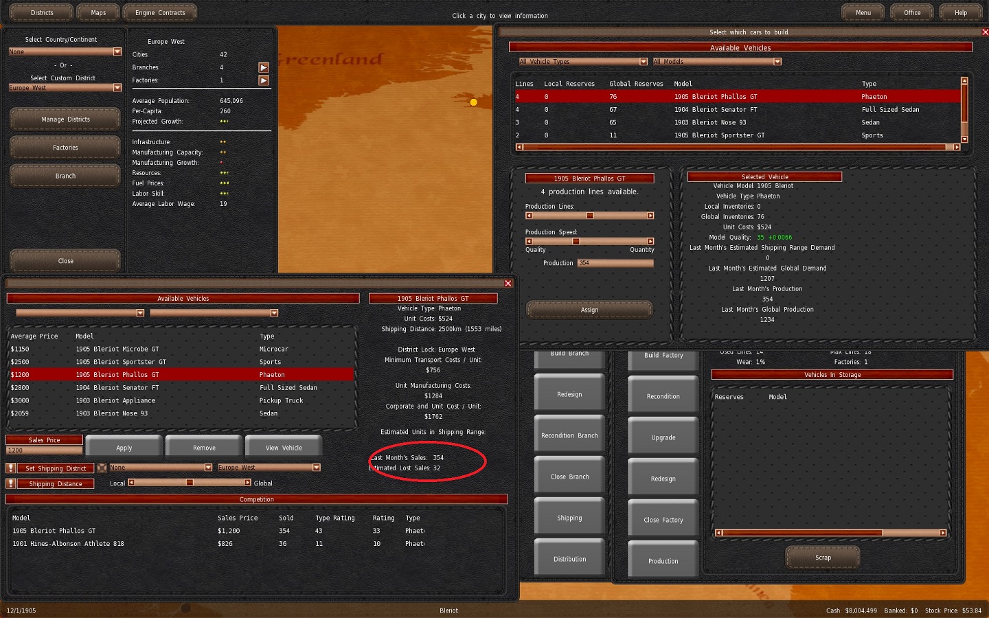

It's is bugged as I showed earlier I had 4 cities drawing from London, but it reported only the London nr., in other words to little.
