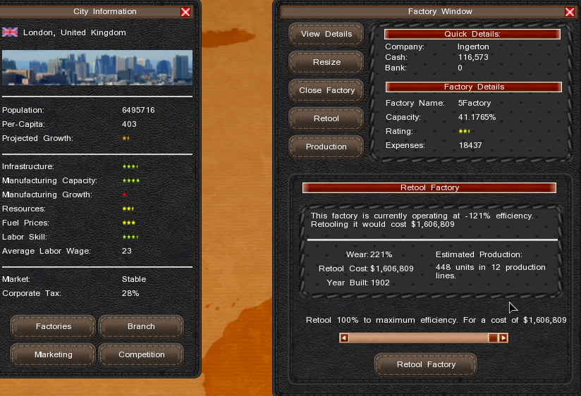

There may be a bug with the general retooling calculation, rather than just branches, look at this.
Again i was forced to demolish in this case the factory and rebuild it, as the retooling cost was out of control.
I suspect it has something to do with resizing/redesiging screwing up the amount of wear on the factory/branch.
-121% efficiency!! Built in 1902 what year was this pic taken?
I've never seen a factory or branch go into negative efficiency but then I generally retool both every couple of years at worst.
(02-04-2014, 12:02 AM)Frankschtaldt Wrote: -121% efficiency!! Built in 1902 what year was this pic taken?
That was a Factory from game start, which i resized, i think the screenshot was from 1903/1904.

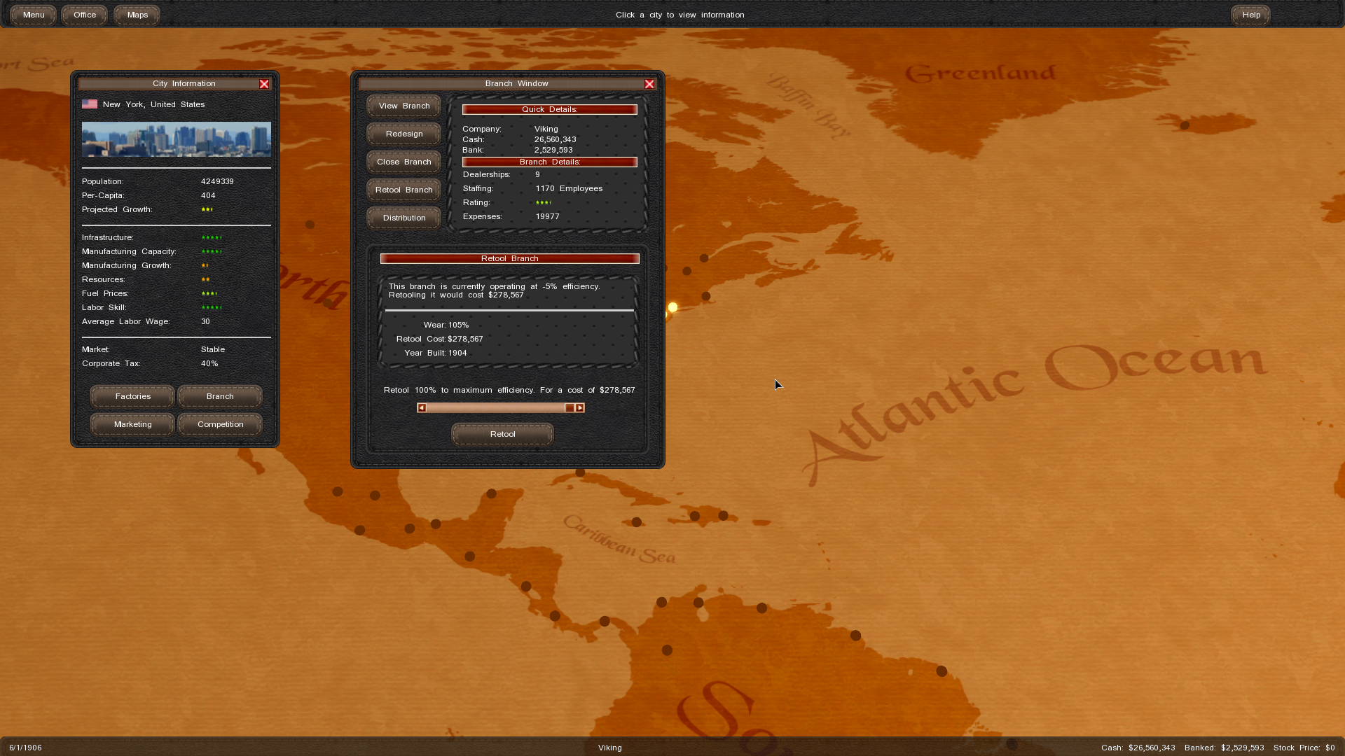

I took a SC of one of my factories in the retool screen
Then i resized the factory
Then i took another SC of the factory retool screen.
The wear hasnt changed.
I also did the same for Branches.
No wear change
Previously, resizing would mess up the wear causing excessive retooling costs.
Perhaps its a new/different bug?

Can confirm this bug is still in.
See attached image. I just re designed this branch (havent even advanced a monthy yet) and it went from positive efficiency to negative.
[Image: hf78HYr.png]
.... and here is a save in case it's useful....
