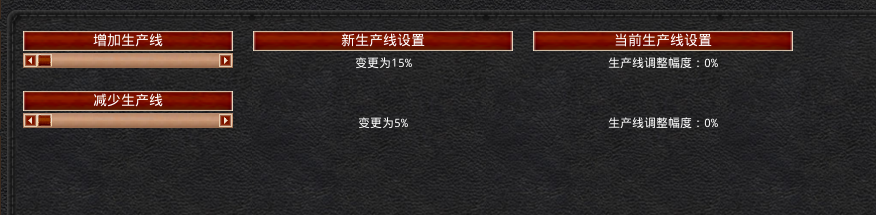

Hard for me to tell in Chinese and without a full screenshot to know where you are in the game.
If it's the old production system, Bounty #17 added the ability for the player to adjust when the auto production system adds a new production line when the AI adjusts production output. https://www.ventdev.com/forums/showthread.php?tid=3799

(08-17-2025, 07:00 PM)Eric.B Wrote: [ -> ]Hard for me to tell in Chinese and without a full screenshot to know where you are in the game.
If it exceeds 70%, the system will automatically build a new production line?

(08-17-2025, 07:49 PM)c0194112 Wrote: [ -> ](08-17-2025, 07:00 PM)Eric.B Wrote: [ -> ]Hard for me to tell in Chinese and without a full screenshot to know where you are in the game.
Yes, in the old system, if the production speed goes above 70% it will add a new production line.

(08-17-2025, 08:02 PM)Eric.B Wrote: [ -> ]Wait, this could lead to misunderstanding.(08-17-2025, 07:49 PM)c0194112 Wrote: [ -> ](08-17-2025, 07:00 PM)Eric.B Wrote: [ -> ]Hard for me to tell in Chinese and without a full screenshot to know where you are in the game.
The actual situation should be that the system converts unused lines into used lines, rather than turning a 20-line factory into a 21-line one.

OK, loaded it up in English.
The top row is when the Auto Production will add a production line. By default this value is 70%. (Start a new game, design a car, set auto production on, go to factory, and check Line Settings)
So, the auto production system will increase the production speed slider until it hits 70%. When it hits 70%, it will add a new production line, and set the production speed slider to the "Decrease Line Value".
The bottom row is for when the Auto Production reduces production. By default, this is 30%. So, when the Auto production system needs to decrease production, it will lower the production slider until hits 30%. When it hits 30%, it will remove a production line and then move the production speed slider up to the "Increase Line" value.
Make sense?
