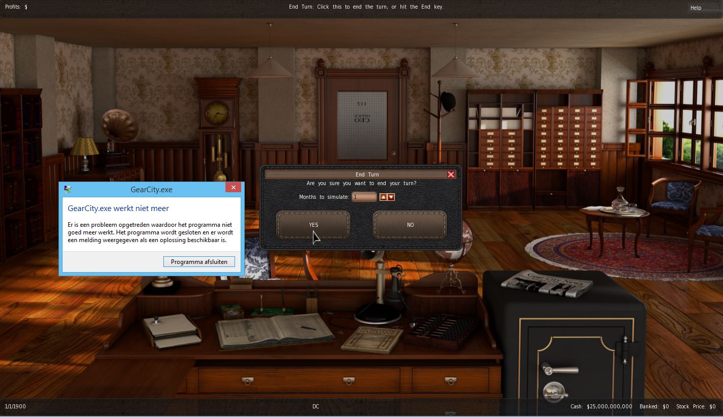

Crash dump when doing end turn (tried it 2 times, 2 times the same happening, the same log entries), even tried it again on new savegame

(10-16-2015, 01:19 PM)jelledc Wrote: Crash dump when doing end turn (tried it 2 times, 2 times the same happening, the same log entries), even tried it again on new savegame
There was a bug updating the game in steam, you should have gotten an update about 2 hours ago that fixed the problem.
Has the problem been resolved or is it still happening?
