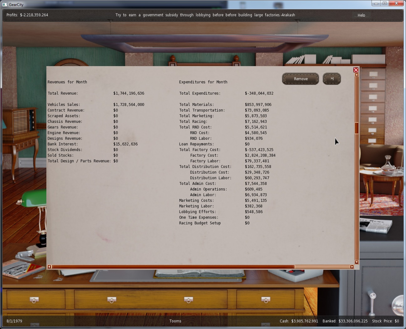

I don't know if this is a bug or I am overlooking something, but it looks not right.
I posted some screenshots.
I went from making more then 500 mil a month to this loss after building a new factory. (I have 13 now)
Sales haven't changed that much.
I also see that the microcar is starting to cost a lot more every month, but don't see why.
Looks like a bug, maybe the numbers of overflowing? If you could send me the save game that would help me out a lot.

Here is the savegames. Smile
Both are of the same game. An earlier autosave and my manual save.
.zip   SaveGames.zip (Size: 8.53 MB / Downloads: 827)
Thank you much, I should be able to look at them tonight!
I've fixed this issue, and it'll be included in the 1.17 patch.
The problem was you grew too large, the game couldn't handle your numbers. But now it can. Smile
Sadly though, you'll lose game progress with the update.
Till then, if you wish to continue this save game, figure out how to make less money than you do. Sorry. Sad

Did you find why cost of the microcar suddenly skyrockets. (last one was 34k+, before it was around 800)
