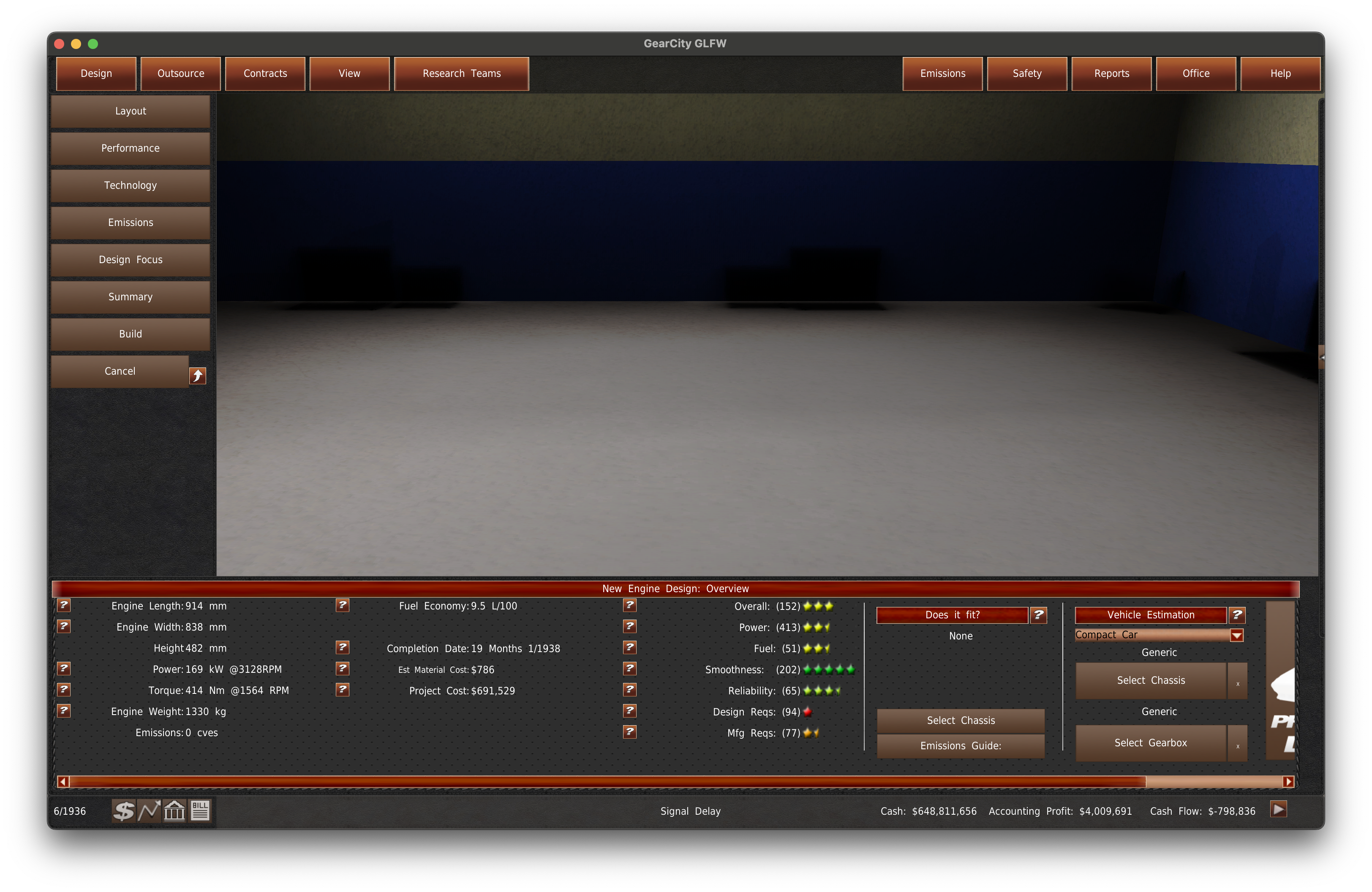

Steps to reproduce:
  1. Go to R&D
  2. Click Modify design of engine `1935 Electric`

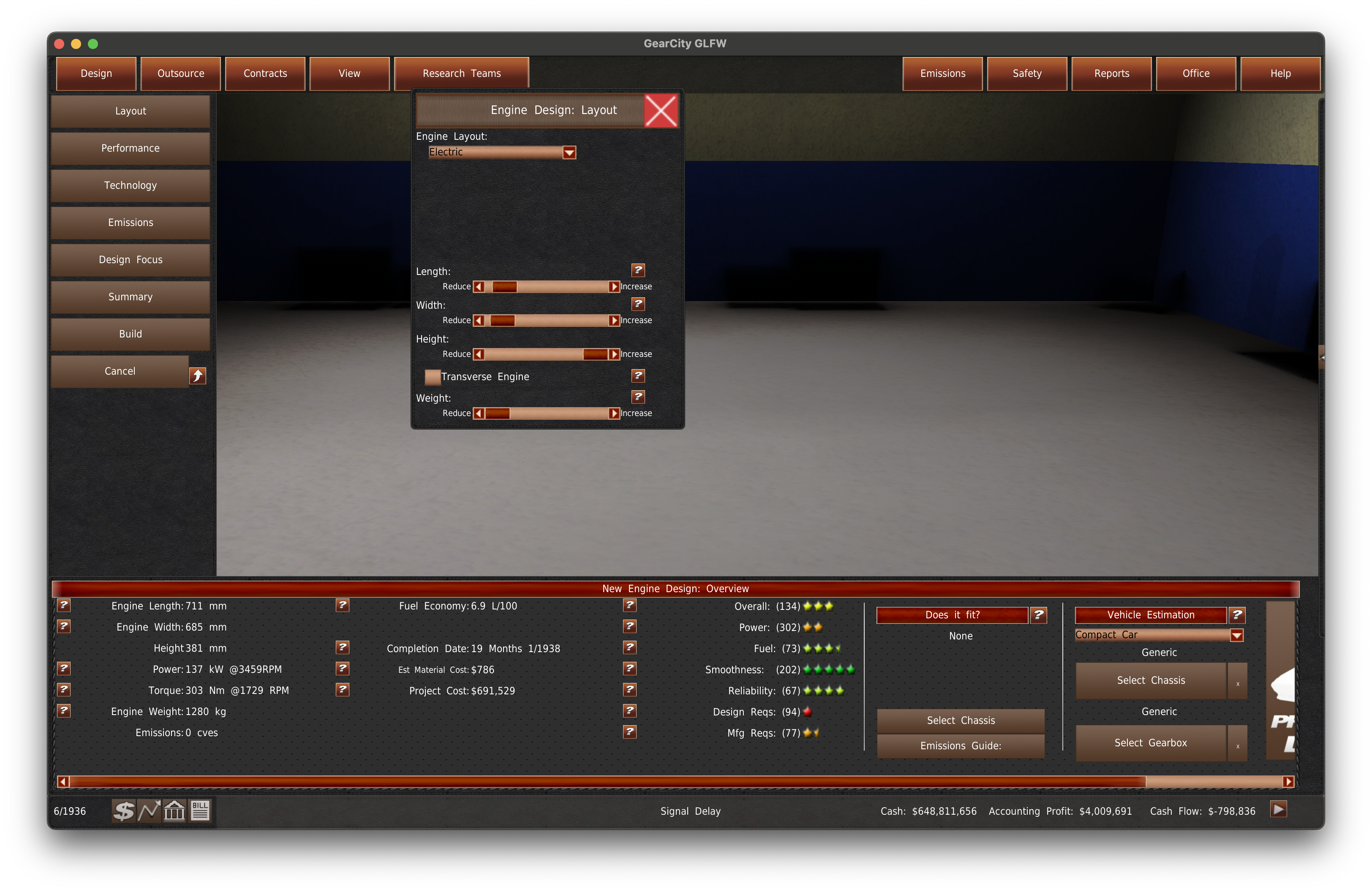

  3. Click redesign
  4. Note that Engine Length and Width are 914mm x 838mm.
  5. Click on Layout
  6. Under Engine Layout, reselect Electric
  7. Note that Engine Length and Width are now 711mm x 685mm
Before:
[attachment=1616]
After:
[attachment=1617]
I got a chance to look at this, and it isn't actually a bug.
It has to do with this issue: https://www.ventdev.com/forums/showthread.php?tid=3868
Internally, every engine has a bore and stroke value saved, even if the engine type doesn't use them. This is used to calculate the size of the engine.
Every year the minimum and maximum bore/stroke values decreases. When you change the layout component, it resets the Bore/Strike values to the percentage of the bore/stroke sliders (even if you don't see it) within that range.
So, in short, Bounty #86 will fix this issue.
