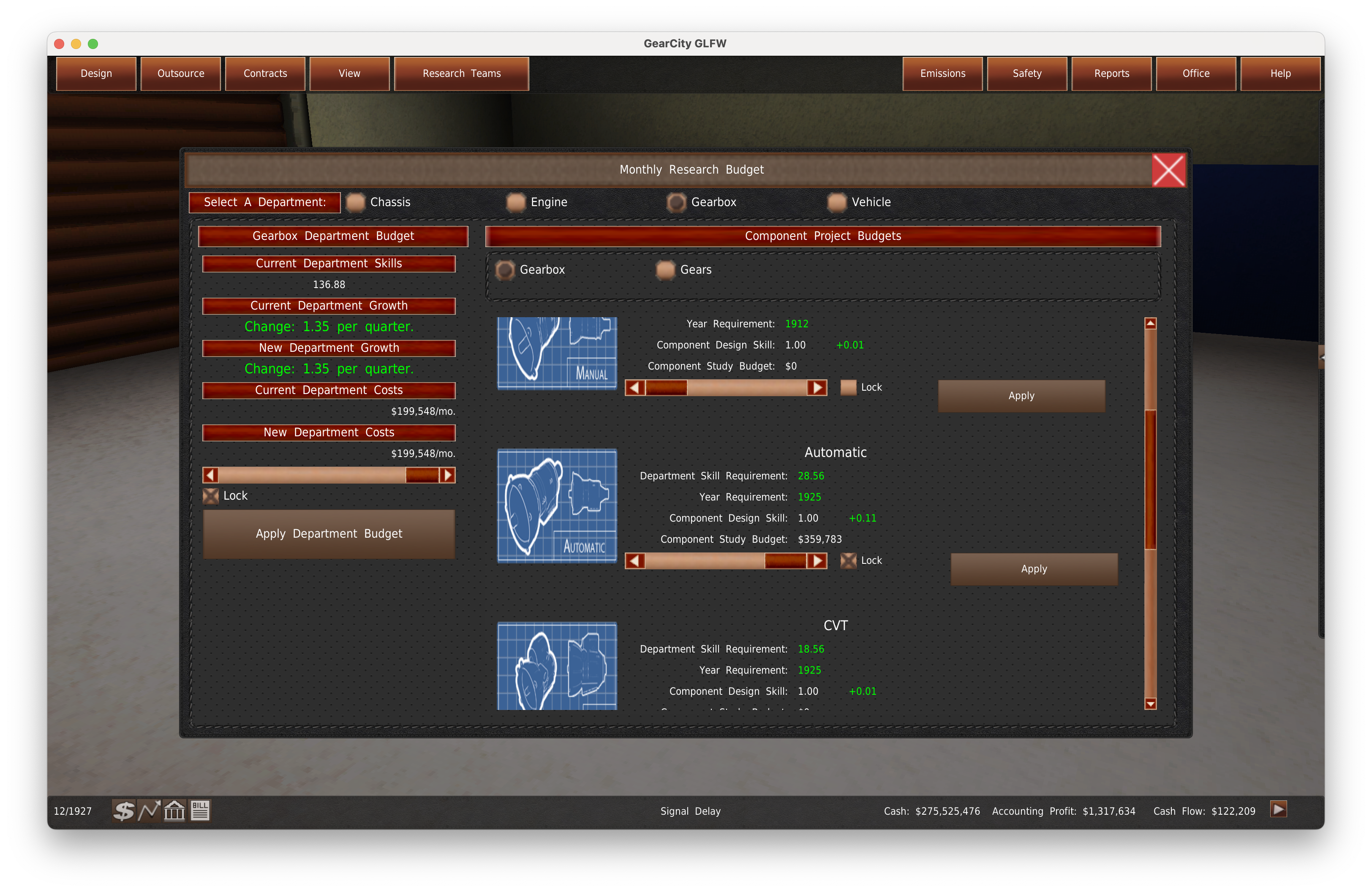

Component skill overview page seems to show wrong data for gearboxes, it shows automatic has no skill while the savegame does seem to think it should have skill:
[attachment=1615]

That said, there is an issue with the optimized SQL for all components skills. So, I will be looking into that. Just here to update you that the GUI itself is correct.
I have fixed a couple other issues related to Gearboxes in the component research screen: being able to set research budgets before the design is active. Not setting the design to active when certain time periods are met. Not correctly coloring active dates, etc. These changes will be in the v2.5.0.2 update.
