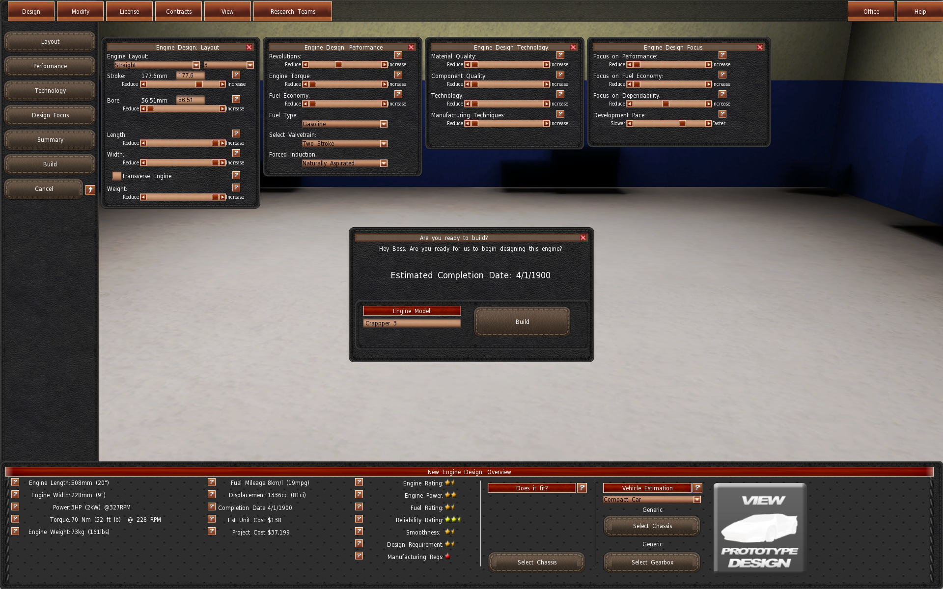

Ive played around a bit with this car design its not been easy for me. I usually got for a sedan with a high horsies but I see torque is way more important. XD
my design are hugely based on power weight... but now I see the error in my ways lmao. I target wealthy (which may be why I go bankrupt lol)
my price usually goes
231~ I-2 for a first engine I find it gets best power (Ill do torque next time)... 8hp 40-50 nms of torque.
30 is my standard gas mileage.
And I leave material maxed out and weight low.
My chasis gears tend to be bad... I go for weight above everything else. for chasis and small. The gear box I usually go for economy 1 gear I get better mileage than you @ like 8mpgs.
22 MPH with car (torque is probably what hurts here)
I always use a t-head over others because for 2-3 dollars you get a significant bump in gas mileage and power.
I usually push out a $1000 car by 6/1/1901 and go bankrupt because I sell like 1-4 cars a month. And my profit margin is super low I usually go for %15 profit+corporate/unit costs.

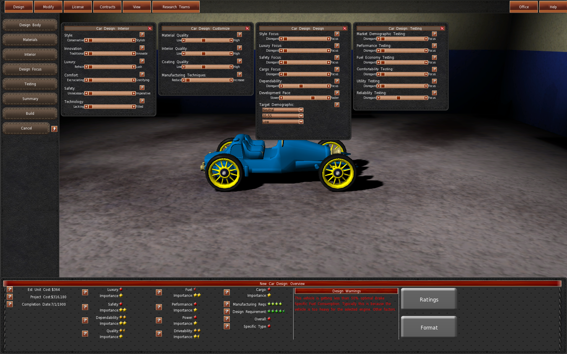

Quote:Well torque is half the variable for horsepower (the other being rotation.) In early game years, the amount of torque output of engines are lower compared to modern engines of the same size. As such if you have a heavy vehicle, you're going to need more torque than horsepower to move it. You can make an engine rotate all it wants, if it doesn't have the torque to push the vehicle along it's not going to matter.
Later in the game horsepower should be playing a little more important role in maintaining adequate top speeds. At which point you can reduce torque and increase RPMs.
Up until you hit the point where you're fighting terminal velocity. In which case torque again becomes important as you need to push back against the atmosphere.
Well I've since modified my design a bit. I've cut back to try to make a car sell close to 2x GDP.
It winds up being a small I-2 3hp (17nm torque) motor. Chassis that, while not great, is lightened as much as possible (via weight, performance, and material). And a light 1 gear gearbox (I find that early on 2-3 gears make little difference if any... 4 gives a slight bump in speed/gas but goes over budget).
All in all it adds up to be a $440~ sedan that doesn't pass many of the Importance stars, but I think its virtually impossible with some (particularly with fuel efficiency). Set Mid-low (quality, driveablity... and safety I think pass).
