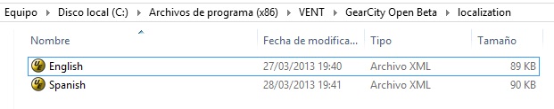

i work in the translation to spanish of texts but not change in the settings please add suport of other languages
only appear the english language
the archives

The last word on this line "Segment0 micross.12 1 0 0 0 Spainish" has to be the file name without the .xml of your localization.
If you have any more questions feel free to ask Smile
